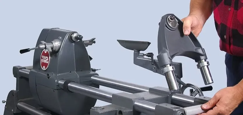

Install the headstock
Slide the headstock onto the left tube and lock in position. Confirm the spindle rotates freely by hand.

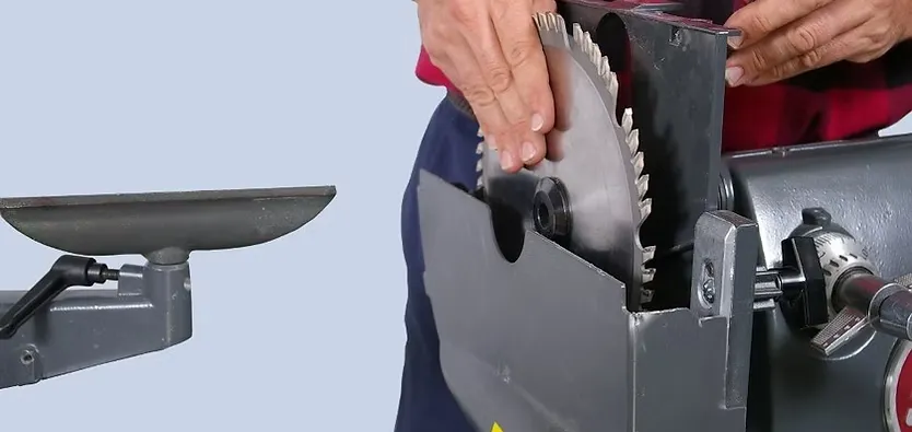

09
Make your first test cut
With scrap wood, make a test rip cut at a low speed setting to verify alignment and confirm the machine runs smoothly.

Table saw blade wobbles
Verify the arbor nut is fully tightened. Check that the blade is rated for the machine's RPM. Inspect the arbor flange for debris.

Lathe tail stock won't lock
Clean the tube surface with a dry cloth. Apply a thin coat of paste wax to the tube. The tail stock lock lever should engage with firm hand pressure.

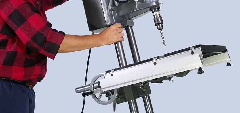

Drill press depth stop slips
Clean the quill rack with a dry brush. Tighten the depth stop lock nut. If slipping continues, inspect the quill rack teeth for wear.

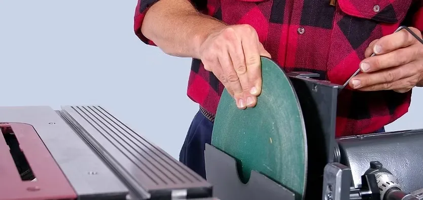

Disc sander table misaligned
Loosen the table tilt lock, set the table to 90 degrees using a machinist square, then retighten. Mark the 90-degree position for future reference.

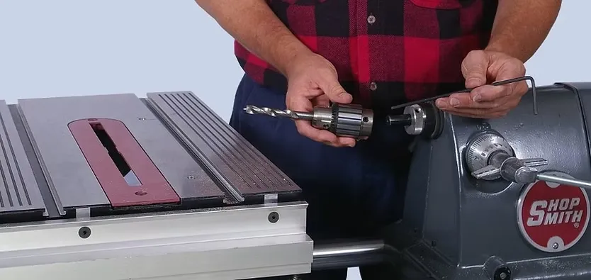

Drill Press to Lathe
40sec
Drill Press
Lathe
Lathe to Table Saw
54sec
Lathe
Table Saw
Table Saw to Disc Sander
34sec
Table Saw
Disc Sander
Horizontal Boring to Drill Press
32sec
Horizontal Boring
Drill Press
