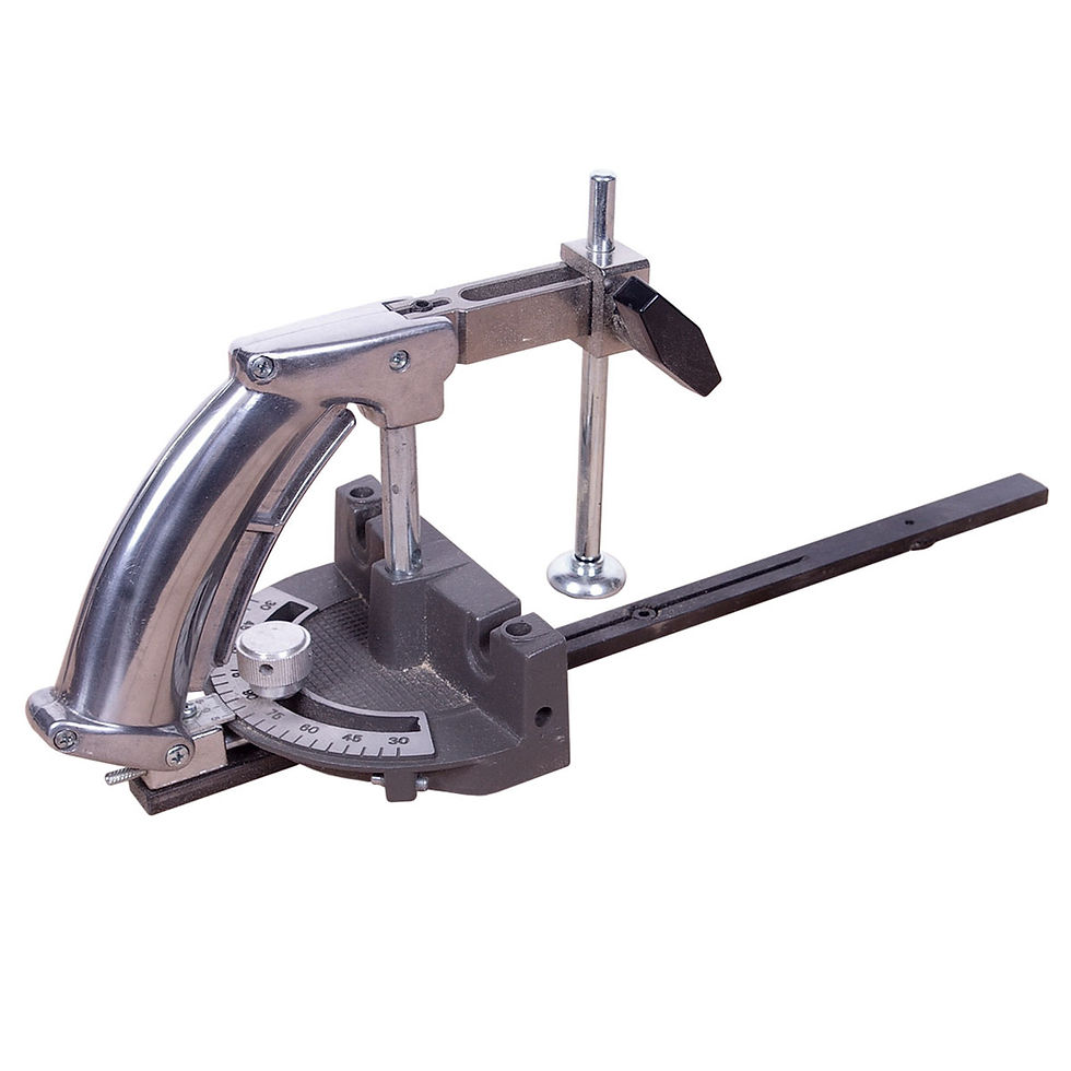

Complete Miter Gauge Package with Safety Grip

Cut all parts to length, according to the Bill of Materials. Shopsmith’s 24″ Miter Gauge Extension Face offers an adjustable stop that you can set to cut multiple pieces to the exact same length with ensured repeatability and precision.
