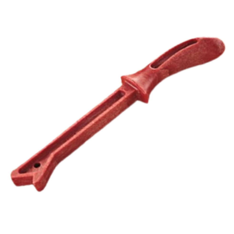

Whenever possible, use safety devices such as featherboards and push blocks or push sticks to keep your hands out of harm’s way. Don’t forget eye protection, as well.
