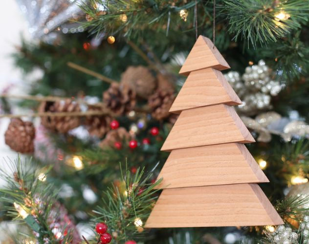

The Sawn Ornaments
Here are four traditional Holiday shapes that can be quickly scroll sawn (or bandsawn) to make great, highly marketable Christmas Tree Ornaments. We made ours from 1/4″ plywood, then painted them with the appropriate designs. However, Ornaments such as these made from attractive hardwoods such as cherry, walnut, birds eye maple, quarter-sawn oak or even some of the more attractive exotics will be just as marketable when left “natural” without painting.
ree
1: Begin by preparing your stock to the appropriate thickness (1/4″) and approximate dimension.
2: Transfer the patterns shown here to stiff cardboard (or similar material) for use as templates.
3: Temporarily attach a stack of Ornament blanks together with Double-Stick Tape in preparation for pad sawing (sawing a stack of identically-shaped objects to shape at once). For a Scroll Saw, this is usually slightly less than 2″ (7 of our 1/4″ thick ornaments) – for the Shopsmith Bandsaw, we’d recommend stacking no more than about 12 of our 1/4″ thick ornaments.
4: Trace your pattern onto the top blank in your stack and cut the entire stack to shape at once.
5: Smooth the edges of the cut-out ornaments using a collection of Small Sanding Drums or a Strip Sander where possible. For really “tight” areas, use small files or hand sanding sticks made by gluing fine sandpaper to small diameter dowels.
6: If you’re planning to paint your Ornaments, start with an oil-based primer. Use a pencil to draw your designs on the primed surface then paint, as desired. Once dried, spray with a clear over-coat of polyurethane or varnish.
7: Drill a 3/32″ diameter hole where indicated in the plans and use decorative string or brass wire to hang them.
