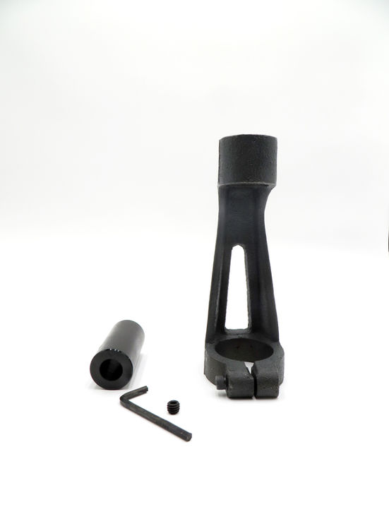

Here's how this tool works. Install your Mortising Attachment over the outside of your quill and tighten the screw. Next install your drill chuck on your MARK?7 or Mark V spindle. Insert the Mortising Chisel of your choice with matching Mortising Bit into the opposite end of the attachment and tighten a setscrew and then tighten the bit in your drill chuck. Position your workpiece against your rip fence, install the hold-down and go to work!
The attachment holds the chisel to keep it from rotating while your drill chuck holds and spins the mortising bit that rides inside the chisel. As you lower the set into your wood, the bit removes most of the waste while the chisel's sharp edges square-shave the sides of the mortise flat and smooth. The special hold-down attaches to the top of your rip fence to keep your workpiece from lifting off the table surface when you retract the chisel.
