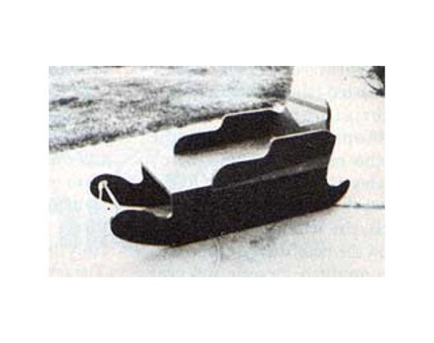

This classic sled will brighten any child’s Winter blues, then double as a plant stand when “Old Man Winter” packs it in for the season. We’ve purposely made the shapes simple so it will be easy for you to duplicate them – or to modify them to a style you like better, if you prefer.
Start by drawing your patterns onto a piece of high quality 3/4″ marine plywood (without voids). Be sure to draw two identical side pieces (B) and two identical runners (C).

Assemble with waterproof, two-part resorcinol glue and wood screws. Stain or paint to your preference, then apply a clear coat. NOTE: If painting, be sure to apply a coat of sealer prior to paint application.
