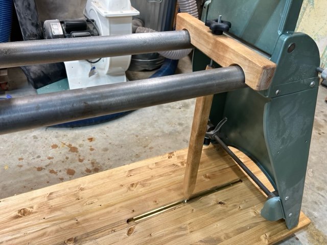

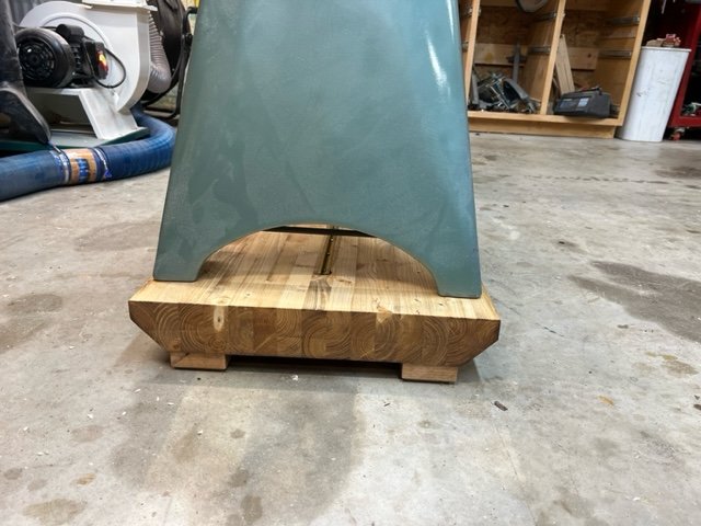

On my third bowl, my workpiece was out of balance and it actually made the greenie walk across the floor. When I finally finished the bowl (a Christmas present for my son) I decided I needed to find a way to make the greenie stay put. I also wanted to raise it up to a more comfortable turning height.
I did NOT want to alter the machine in any way, so no cutting or poking holes.
Here is what I came up with.

I am estimating I added about 125-150 lb to the overall weight. The Mk V is pulled to the surface of the pallet by the two bars across the bench tubes and down to the T Track. I still need to add retractable casters, but that can wait because it does not need to be moved often.
I still want to make my own knobs for it, but I temporarily used 1/4-20 knobs from another jig. I also need to break it all down for a couple coats of polyurethane and to add epoxy to the T Track in addition to the screws it came with.
My initial plan was to build a 3 inch bottom that would hold about 150lb of concrete underneath. I can still do that if needed, but for now I will try just the four feet. It seems pretty stable and solid.
I tested it out on a piece of scrap wood and the height is much more comfortable. Also, I can tuck my tow underneath for better positioning.

On second thought I will need to add more weight. I way overestimated the weight of the 2x4 lumber.
I have the pieces cut to rough lengths, but will wait until I get a set of retractable casters before building that part. Then with some rebar and cement, I will get the weight I am looking for, but still be able to move it if needed.
