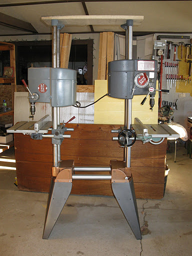

We had company most of the day yesterday from about 11 AM on until evening but I did manage to get the Push me - Pull me drill-press moved yesterday morning. It was not as bad to move as I was expecting it to be. It would have been horrible to move in one piece though, tall and top heavy. Since it uses 2 pivot ends I just stripped off the tables and the levers etc. and loosened the set screws at the pivot ends. I left the headstocks at one end and locked the carriages about a foot from the other end. I pulled it apart into 3 pieces and carried them out to the truck. At the new shop my wife helped me carry the 2 way-tube sections down the stairs into the basement shop. I was feeling so generous that I even gave her the light end. :) They were not that heavy but it was just a lot easier winding through the old basement with 2 people for balancing.
I put it all back together in the new shop but I still don't have the caster set installed on it yet but it is laying under it to go on as soon as I get a chance. Today was supposed to be a day off but it turned into a kind of crazy "horse day"...
Here is an older pic of the Push me - pull me for those that don't know what I am talking about.

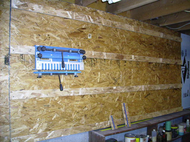

Finally getting in a little shop time again and got started on my wall storage system. Dang I work slow anymore. :rolleyes:

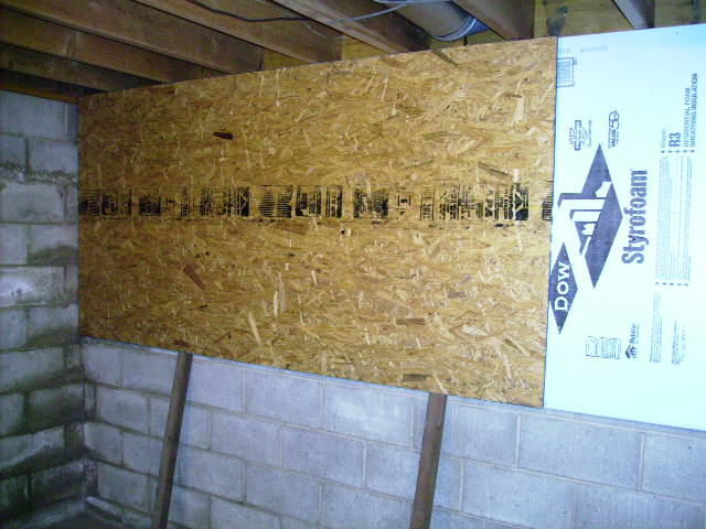

Before anyone worries, those are just old stains on that corner wall from many years ago. In spite of appearances that wall is stone dry and has been for a long time. I'm not sure why it looks so dark in the picture it isn't remotely that dark in real life. :)
Painting is a good ways away yet.

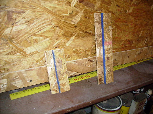

I'm using 1/2" foam board behind the panels then hanging both from the sill plate.
The rails are made of a 1.5" strip of 7/16" OSB as a spacer with a 2.5" front face of .25" OSB. Hangers will be identical but flipped. Everything is glued with Titebond. The faces of the rails are glued and stapled (air nailer/stapler) to the spacers then the rails are glued and screwed to the panels. This section is where my bench will sit about 4' or so from the wall and I will generally work standing between the bench and the wall with my back to the panel. This section will mostly be misc. hand tools like chisels, screwdrivers etc.
I felt the need to hang something up so I grabbed the dovetail jig that has an "L" flange on the back and hooked it over a rail. :) Some of this area will be some smallish peg board panels. I have a lot of pegboard hooks and hangers from our store.
One 8' panel done, 9 more to go...
