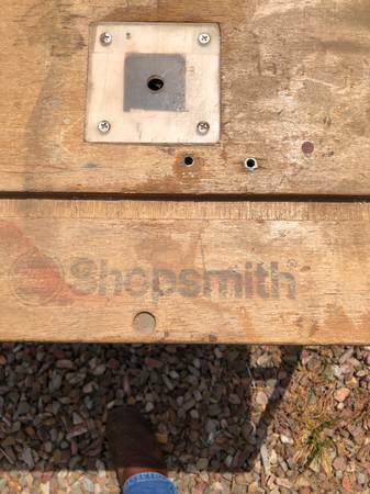

I saw this novel(?) use of the Router Arm on CL: https://phoenix.craigslist.org/wvl/tls/ ... 38417.html
SS Router Table.jpg (28.74 KiB) Viewed 2458 times
SS Router Lift.jpg (32.97 KiB) Viewed 2458 times
SS Router Arm.jpg (21.95 KiB) Viewed 2458 times

That's interesting! I have the most recent (Shopsmith-mounted) version of the pin router set up which has the Shopsmith-mounted router arm. Without going to look at it, I think it would be a fairly simply matter to mount the router arm so that when the Shopsmith was raised vertical the router arm would be below the table for under-table routing using the arm as a lift. Remove the tie bar [edit] guard underneath the main table and it might work for under table routing with the Shopsmith shaper/router table insert. Sort of a poor man's Mark 7.

I love the idea, I think it would provide superior under table router capability. I have a nice router table setup with the other style arm but would occasionally like to leverage the 520 table system. So far have not found the Mark-mounted OAR parts at a price I can live with. But I gotta say the idea of removing the main table tie bar is not for the faint of heart.

Sorry, I gotcha now. Seems like the open question would be clearance/interference between the OAR casting and the tie bar. The free-standing OAR that I have puts a lot of bulk around the router body, I don't think there's any way it would go that would not interfere with the tie bar. If you try this and it works out please let us know. I want one.

DLB wrote:Sorry, I gotcha now. Seems like the open question would be clearance/interference between the OAR casting and the tie bar. The free-standing OAR that I have puts a lot of bulk around the router body, I don't think there's any way it would go that would not interfere with the tie bar. If you try this and it works out please let us know. I want one.
- David
If the Mark 7 can be used as an undertable router using the main table and the Shopsmith power head, I would think there would be enough space to try the Shopsmith-mounted pin-router arm. At some point, I will give this a try and report back.
