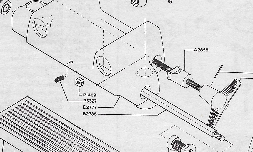

As you know Everett has been working on restoring all the pre Shopsmith Inc. Mark 5 Manuals. I have many of the original manuals he is using. Below is a section of the parts diagram from the 5th Manual we believe is from October 1955. Note the stud in the center of the carriage backed by a nut to lock it in place, similar to but shorter than the Model 10's. This was the same for previous manuals but changed to the spacer ring by the next manual (Oct. 56) I have.
Manual 5 Page 27 c.jpg (192.52 KiB) Viewed 19011 times
Part Numbers
P6327 - Screw - Headless Set 5/16-18x3/4
P1409 - Nut - Light Jam 5/16-18
I have restored 2 Greenies. The first was made about June in 1956 has the stud spacer. The other made about a year later has the spacer ring. Both of these were made during the time I have only estimates for the production dates.

I was having second thoughts about what I said above when I looked ar Danimal's modified greenie carriage(stud and nut). Later I remembered MickyD's greenie that was busted there due no doubt to a not very gentle collision between the carriage and the headstock.(think raising to vertical after neglecting to lock the headstock! :eek: ).
So I be corrected. Learn(re) something every day.

Re: Does Size Matter - Arbors
One of the things I enjoy about this forum is we are always learning from each other. Given the choice between the stud or spacer ring I would choose the spacer ring having seen both. It does make me wonder if the spacer ring would have saved MickyD's Greenie from damage.

chapmanruss wrote:One of the things I enjoy about this forum is we are always learning from each other. Given the choice between the stud or spacer ring I would choose the spacer ring having seen both. It does make me wonder if the spacer ring would have saved MickyD's Greenie from damage.
Oh I think the localized force exerted by a ring to the stouter area of the carriage around the way tube bore would be orders of magnitude less than that exerted by the stud/nut on that thin web when the stub is impacted by the high inertia headstock. :eek:
