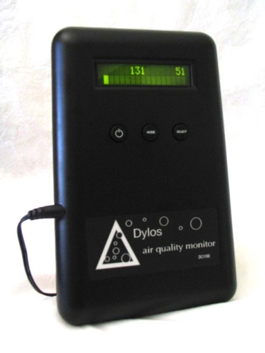

Since your shop has some connection to your house (door, etc.), I highly recommend spending $200 on a Dylos (DC1100 PRO) air quality monitor so you can see what dust level you have in the shop and what might be getting into the house.
P.S. When I used my Shopsmith DC3300, I always had a rise in ambient dust in my shop even though I sealed all around the motor, etc. inside. That supposed 1um dust hood on it still pumps out a ton of small particle dust that is bad for your lungs. When I started with my ShopVac experiment I didn't know if it would work or not, but sure enough the HEPA bags and filter on it excel compared to the DC3300 and the airflow is nearly twice as much.
