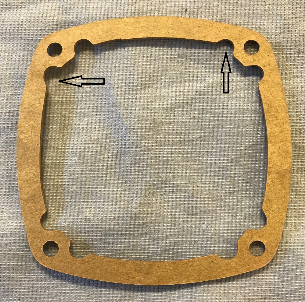

As John said above most of those are pretty easy to take care. Shopsmith no longer makes parts for the Jig Saw but still has some left in stock. The gasket is not one of them. You have the Oil Gasket as part number 502270 which is actually the Housing Cover. The Cover's Gasket is part 502274.
The airline is the same as Aquarium tubing and is easy to find.
When making a gasket for the main housing cover remember there is a breather hole under the upper right screw hole in the side of the housing. The gasket has to be cut so it does not block the hole. The picture below is an original factory gasket. Note the indents at the arrows. Only one indent is actually needed and would be placed over the vent hole.
Jig Saw Gasket - arrows.jpg (613.53 KiB) Viewed 18311 times
The gasket could be left solid except for the 4 screw holes and the breather hole.
