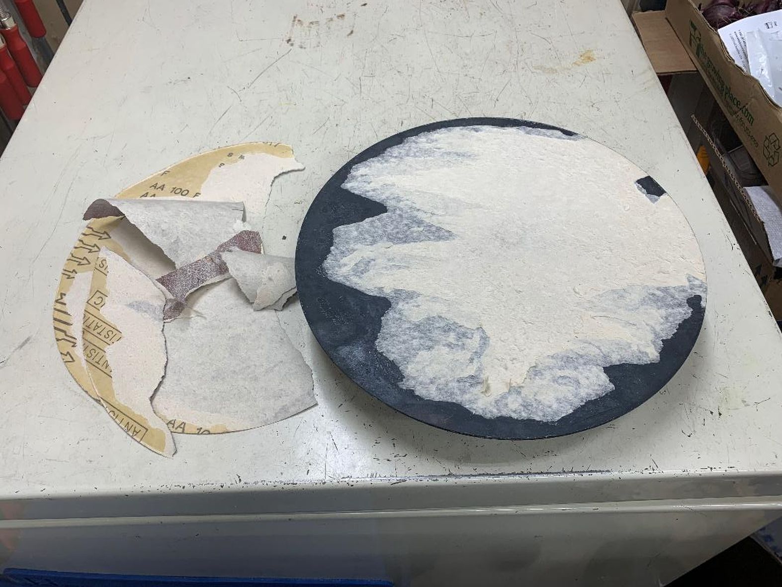

Cold test............. don't do this...........
OK it sounded good but the results are worse then I have ever had with heat and it is not even close.
This was a 100 grit shopsmith sanding disk:
cold test.jpg (246.54 KiB) Viewed 34646 times
This will be my only test for the day since I will now have to spend the rest of my time trying to clean this up.
Re: Using Cold to Remove Disc Sand Paper
40 minutes later I have a clean disk........
