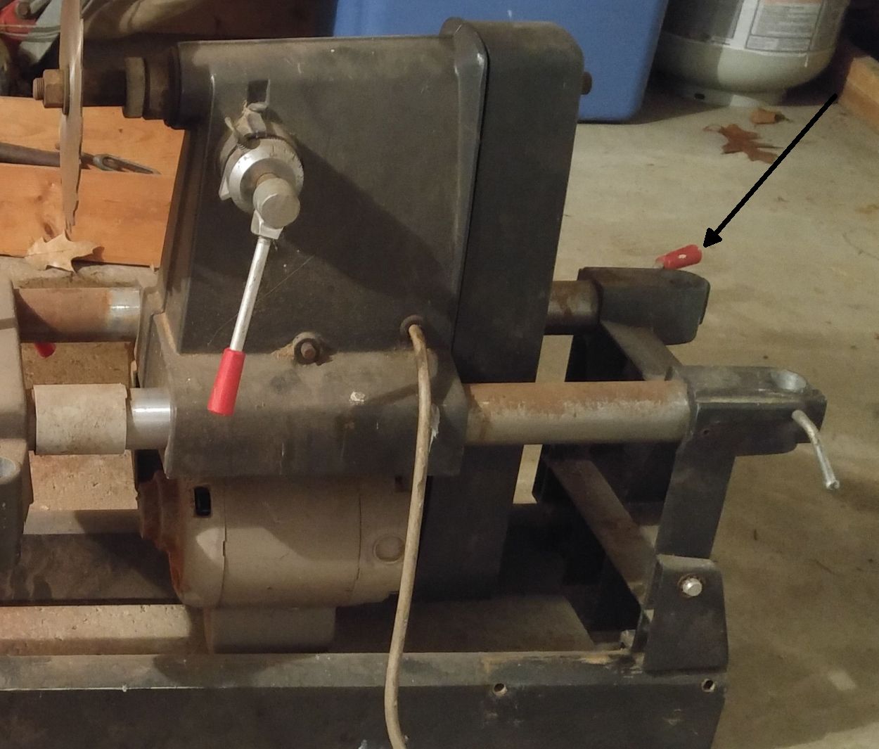

Need another picture. The knob viewed from the other side indicated by the arrow below.

Thanks for the motivation guys. The guy I bought the Mark 2 from aparantly 'inherited' it when he bought his house. I'm sure it's been sitting in his garage for a while. I'm glad the pictures are helpful, I can take plenty more.
On the topic of electrolysis, I'll give it another read and maybe give it a try.
For the center, if I remove the rust and polish it a bit, it should work fine then, correct?
I will be sure to get the other picture to you, JPG, later today. Had to run out and work on a project for school. I look forward to the restoration!
