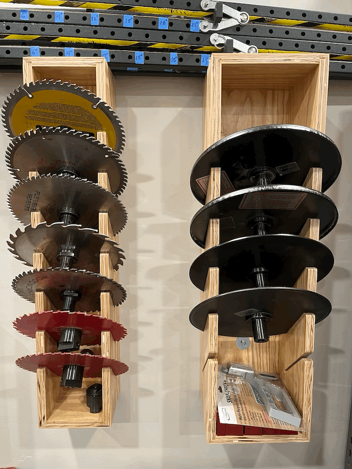

I have three non-Shopsmith 1 1/4" blades: two from Forrest (Woodworker II and Plywood) and one from Ridge Carbide (TS200 super rip). All three blades make glass-smooth cuts (the three workhorses are in the middle of the storage rack). I clean them at the end of each project and after a good scrubbing all three blades are as sharp as when I took them out of their packaging 5 years ago. I can highly recommend both companies and these blades in particular.
One other thing. When using the table saw I've gravitated towards using the lower end of the recommended sawing speed. That seems to give me more torque so I rarely bog down even when working with 2" hickory (it's really hard!) or 2" cherry (it's prone to burning). Most cuts yield a glue-ready joint.
Finally, I borrowed jsburgers idea for storing saw blades with arbors (viewtopic.php?p=258776#p258776). It worked so well for saw blades that I almost immediately built one for sanding discs (both regular and conical). One thing I really like about the Mark V is that arbor system makes it so easy you can always have the right blade or grit for the job. I think that is an under appreciated jewel of the Shopsmith ... although you probably don't need seven blades like I have!

Interesting miter joints!
