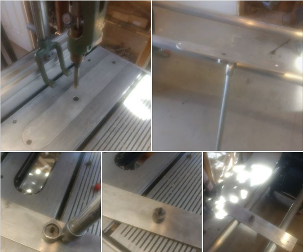

I hate to refer you over to the Facebook group, but if you are on Facebook join the Shopsmith Owners Group there. In it, you can search the group for "flex" and find a post by Geoffrey Baker (link below). He took some 1/4" thick Al bar stock and made an insert for the table, then attached a telescoping leg to the back of it. He said this greatly improved the flex problem he had while doing mortising on his Shopsmith. This is probably my next step because I have a project with some mortising I need to do next in my shop. The last time I used my Shopsmith for mortising, I wasn't very happy with it. I posted a pic below from Mr. Baker's FB posting for illustration, so he deserves all the credit. I hope he doesn't mind me posting it here...
