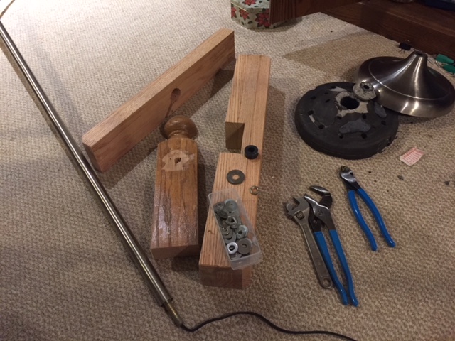

My wife has had troubles with her study-room lamp base. It's a crappy imported cast-concrete base that finally disintegrated. Seeing this thing, I'd be REAL careful using any similarly-made exercise barbells made in China....
But I digress. It was time for a sturdy fix.
Here I am transferring the design from the original junk to a new oak crossbar scheme. I'm using dumpster-dive bed-post Oak that my neighbor kindly saved for me :)

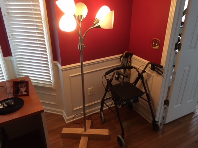

Here is the finished base:

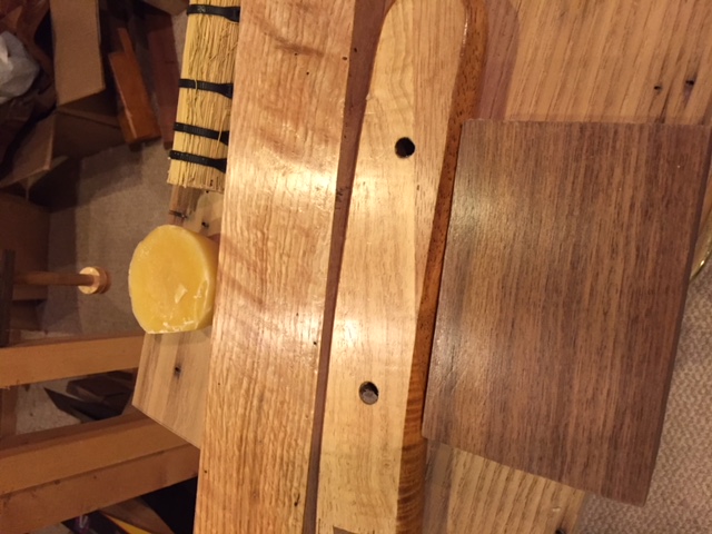

As a side note, that finished Oak base was finished in minimal time (necessary this week due to visitors arriving soon!), and it doesn't smell like oil or varnish. It just has a subtle beeswax odor.... I decided to try out the old-time "polissoir" method that is promoted by web-authors such as Don Williams http://www.donsbarn.com .

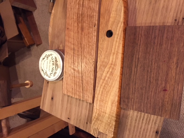

We've all heard from Nick, etc., that you can't build up much of a wax coat because new wax dissolves old wax. Well, that's true if it's a wax in a solvent mix. But raw beeswax can build decently, and have a decent grain-filling function.
Here's a paste-wax test followed by the friction-polissoir-beeswax test:
Paste Wax Segments.JPG (110.13 KiB) Viewed 10470 times
Polissoir Segments.JPG (112.01 KiB) Viewed 10470 times

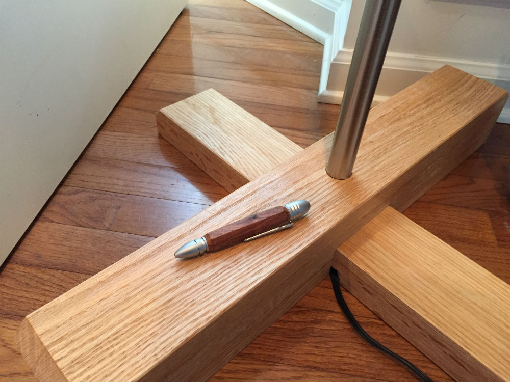

I thought I would report on the "hard wax" beeswax finish which was burnished-in with a polissoir (described above).
The Oak piece has held up great!
Here is the year-old lamp-base, and a new experimental octagonal pen on it, having a similar burnished wax finish:
Beeswax Base 1 year On.jpg (134.05 KiB) Viewed 9376 times
