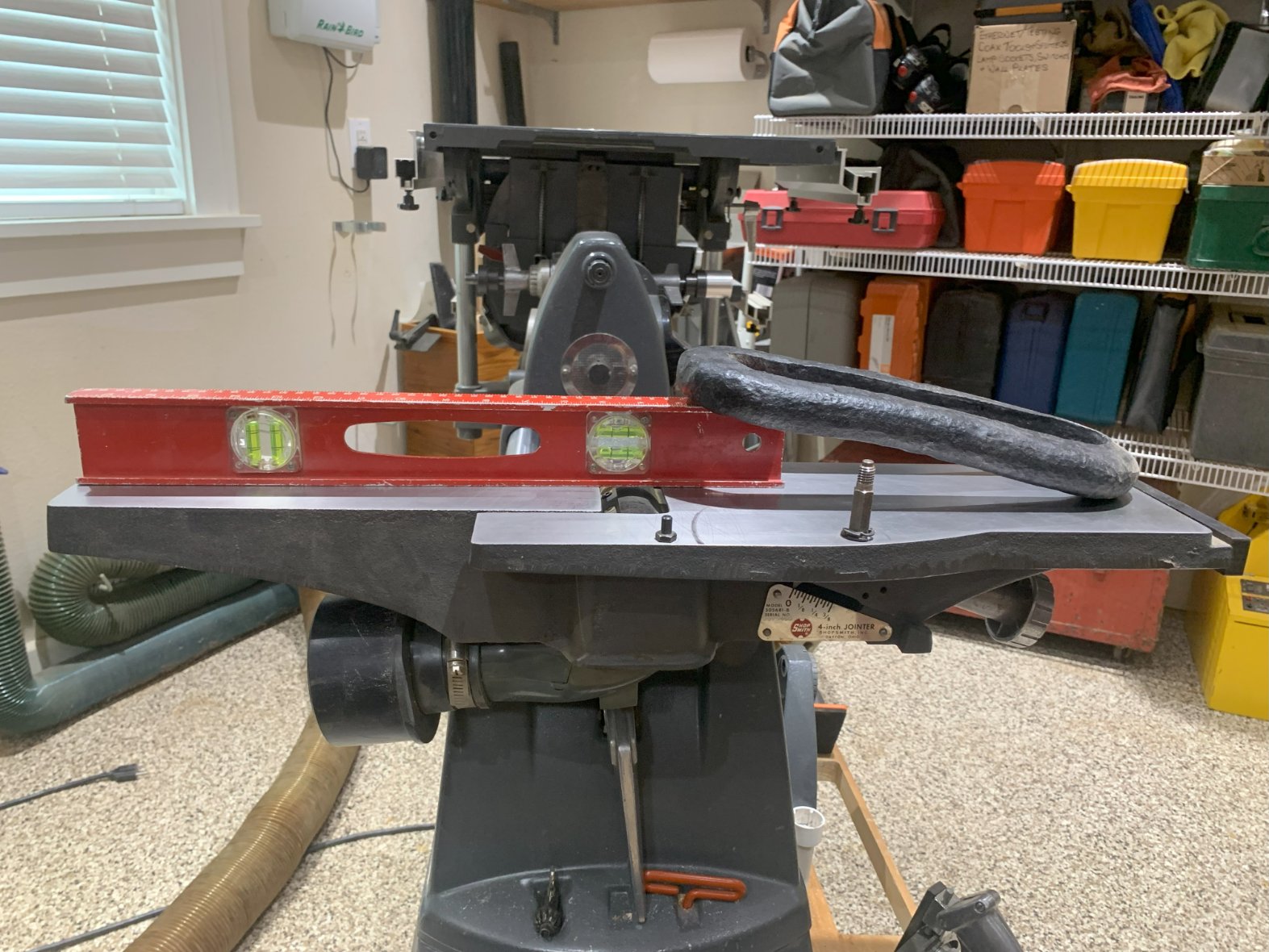

I'm experiencing concave cupping when edge jointing (there is a slight gap in the middle of two edge jointed boards put side by side for glue up). I've read through previous forum discussions and ruled out blade height setup (mine are bang on the 1/8" of drag recommendation) and jointing technique (I'm carefully transitioning pressure to the outfeed during the cut). Then I saw a note about checking infeed/outfeed table alignment and discovered that my infeed and outfeed tables are slightly lower at the far ends than in the middle when set at a zero cut height (the tables are not coplanar). I figured this out by first adjusting the infeed table height until a straight edge on the infeed table would just slide on to the outfeed table without catching. Then I anchored one end of the straight edge on the infeed using a heavy weight and extended the other end over the length of the outfeed table (see attached pictures).There is a gap of about 0.015" between the far end of the outfeed table and the straight edge. Interestingly, this is just about the same gap that I'm seeing in the middle of two 16" boards placed jointed edge to jointed edge. Following previous forum advice I removed the infeed table and cleaned out the sawdust and other crud on the mating surfaces before re-assembling, but the slight outfeed table droop remains.
Going back to jointing technique I reasoned that if table droop is the cause of the gap I should be able to minimize it by (carefully) maintaining pressure on the infeed table as long as possible during the cut rather than smoothly transitioning to outfeed table pressure as soon as the board moves past the cutter head. I tried it and the gap essentially went away, but it definitely wasn't optimum from a safety perspective and would be difficult with longer boards.
The gap is not huge and I can get rid of it by ripping the jointed edge but with a properly aligned jointer I shouldn't have to do that. A few years ago someone (Bill Mayo?) mentioned he had taken a couple of his jointers to a local machine shop and had the tables re-milled together to ensure they were coplanar. That's my next step unless anyone has any other good ideas. I am the originial owner of this 1985 jointer, have never dropped it, and both tables are original so they should have been milled flat together when it was manufactured.
Does anyone else's jointer have this issue?

The outfeed table obviously is immobile. I guess I'd set up the straight edge on the outfeed table and work on shimming the infeed table co planar.
"We prefer to shim the outfeed table, because its adjustment range is very small, but if your jointer has a fixed outfeed table, you have no choice but to work with the infeed side."
https://www.woodmagazine.com/tuning-up-your-jointer

Al - Thanks for the link. I like the double triangle method suggested for checking table alignment because it eliminates the need to have the tables at the same height. I'm not sure about shimming though. I'll have to take another look, but I'm not sure what would hold the shims in place.algale wrote: ↑Fri Jan 26, 2024 2:43 pm The outfeed table obviously is immobile. I guess I'd set up the straight edge on the outfeed table and work on shimming the infeed table co planar.

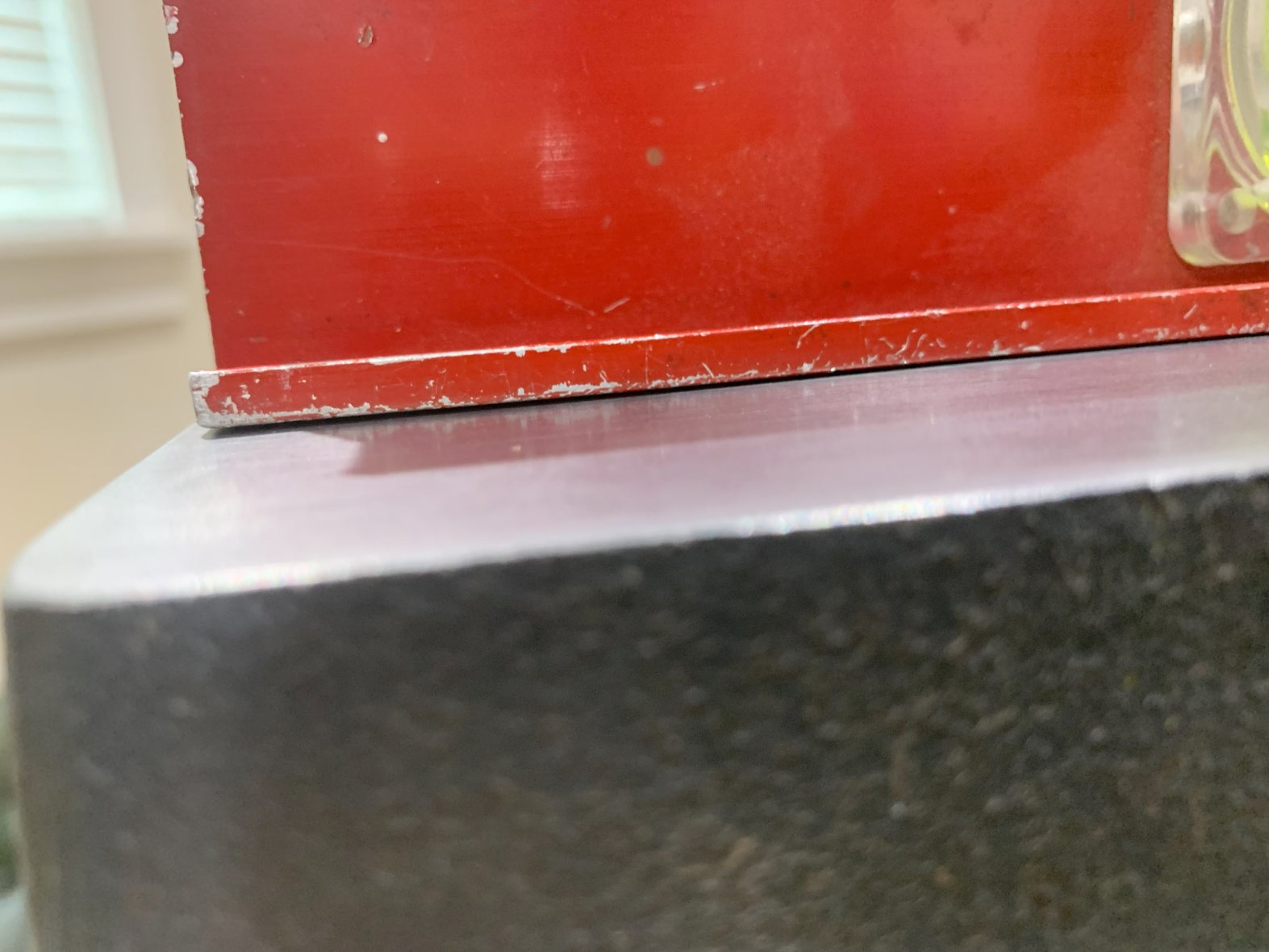

JPG - I had the same concerns about using the level to check table alignment so I double checked it using the steel rule from a combination square & got the same result. The level just has a wider base and was easier to hold in place with the iron weight while I fiddled around trying to get the tables aligned. I'm convinced the table droop is real, but as you point out the more important question is whether it is significantly contributing to the cupping problem.JPG wrote: ↑Fri Jan 26, 2024 4:25 pm A spirit level is a poor reference straight line.
