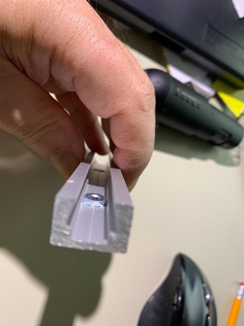

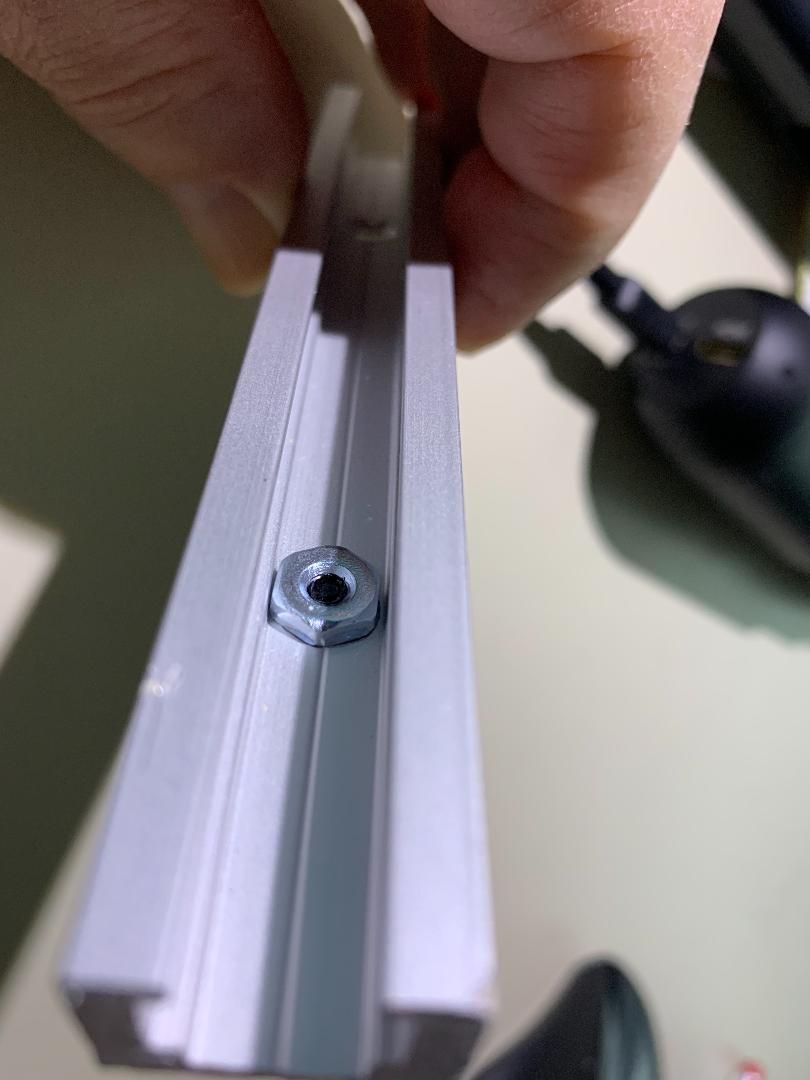

This is track I own so if you happened to have some other brand or style this might not work as well or at all. The base of the jig is counter bored for the heads of the fasteners and through hole allow the fastener to come from the bottom and go through the tracks holes and a nut can be added.
Not breath taking or new but I like the application of hardware in this manor.
Here are a couple of pictures:
The method of attachment should allow 1/4" t-track hardware to be used. If so then this can have a lot more applications.

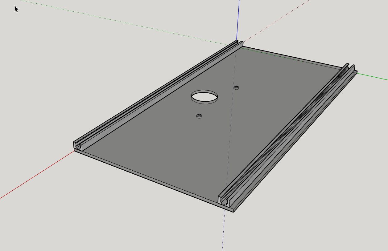

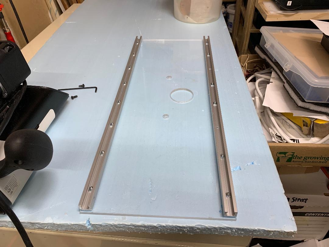

A few changes to my design. First I decided to make the jig just fit the SO and the two t-tracks. The added plastic didn't really do much so why have it??
Second the hex nuts were difficult to install, more so then I expected. So I went with some square nuts. The machine screws of the correct length should arrive on Monday. Until then I had a few longer ones which I used to get things mounted and make sure I didn't mess the design up too much. The screws I have in there are a round head and taller then the ones I was planning for so I can't really use it until the real one arrive and I swap them out.
I used sketchup with fabber plug-in to generate the file and the SO to do the holes. The placement of the center hole was a little off but I'm sure it was my measuring or my layout the was the issue, but it is no problem since I made the hole oversize.
Her is a picture of the jig with the t-track mounted:

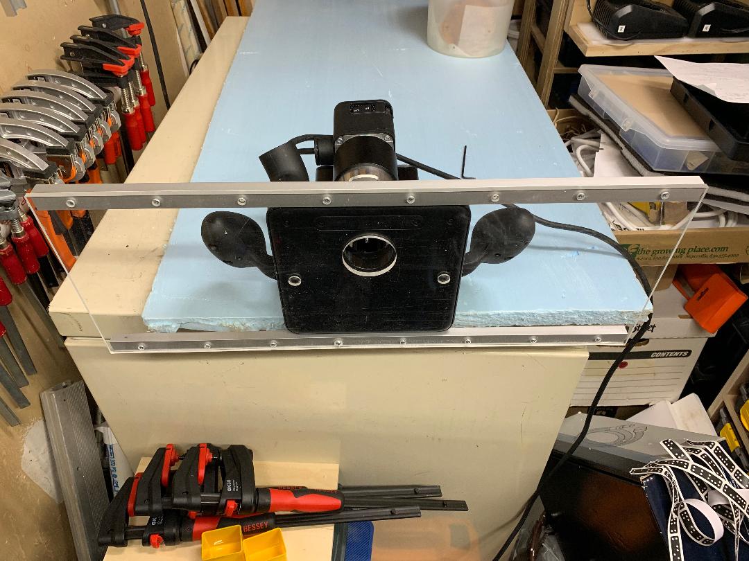

It mounts like so:
mounting SO.jpg (138.27 KiB) Viewed 19124 times

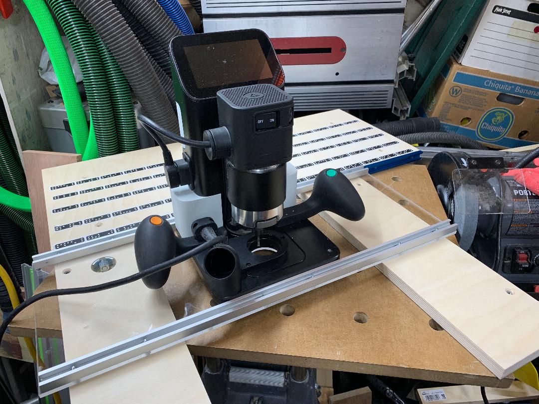

Here is an example of how it will be able to span a lot farther then the stock base allows:
SO spanning.jpg (168.71 KiB) Viewed 19124 times
If things go right I will try it out next week sometime.

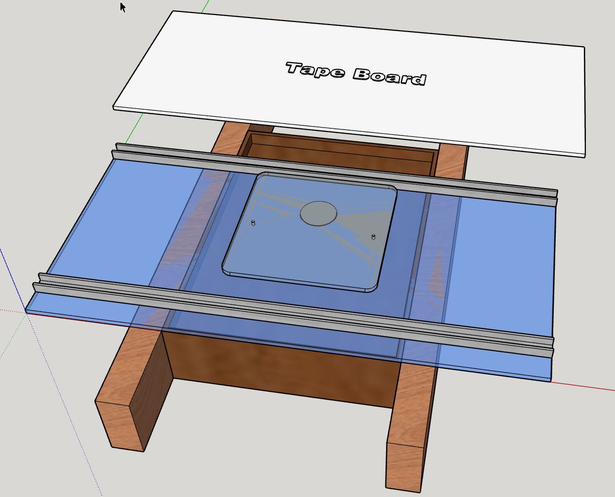

Yes that would be my hope. I know other have used the SO resting on the insert material but I can also see that being problematic depending on the cut out. Any cuts already made become potential "catch" surfaces as you move aroung, this might not be an issue as the foam is pretty forgiving.

The tape board or surface really needs to be at the same level as the SO. The set up pictured would not work well it was just to show the spanning. The tape board I would use is the same thickness as the plastic.
I have a collection of tape boards. In a lot of cases the SO never goes over the tape board. I do sometimes add tape to the work piece and supplement with the tape board.
