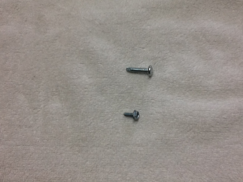

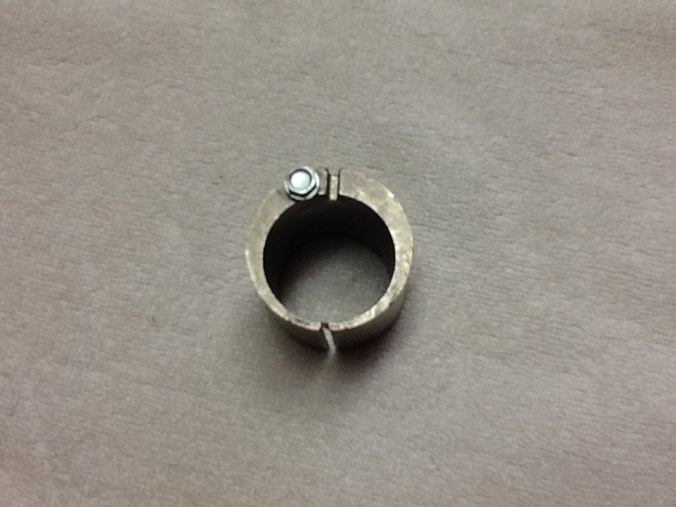

I think the screw is # 48 on the exploded diagram (see page # 6 of the PDF - part # 448027). From the diagram, it looks like the same location as screw # 104 in the exploded diagram (part # 515616). I have that screw. It is the bottom screw (3/8 inch) in the attachment.
. The top screw (3/4 inch) appears to the "pan head" screw that I found the broken head. But, I can't figure out where it goes.
Screw # 104 is the one I removed from the eccentric bushing.

#47 is a much larger screw(5/16-18??) that squeezes the headstock around the eccentric.
If there is a tapped hole immediately above the eccentric bore, that pictured screw goes there. I believe it also needs a flat washer. I will look at the explodes parts diagram an return with a "#".
OK, it is #48
