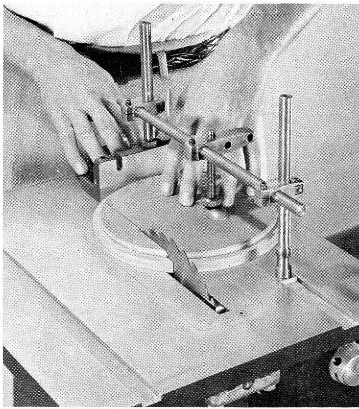

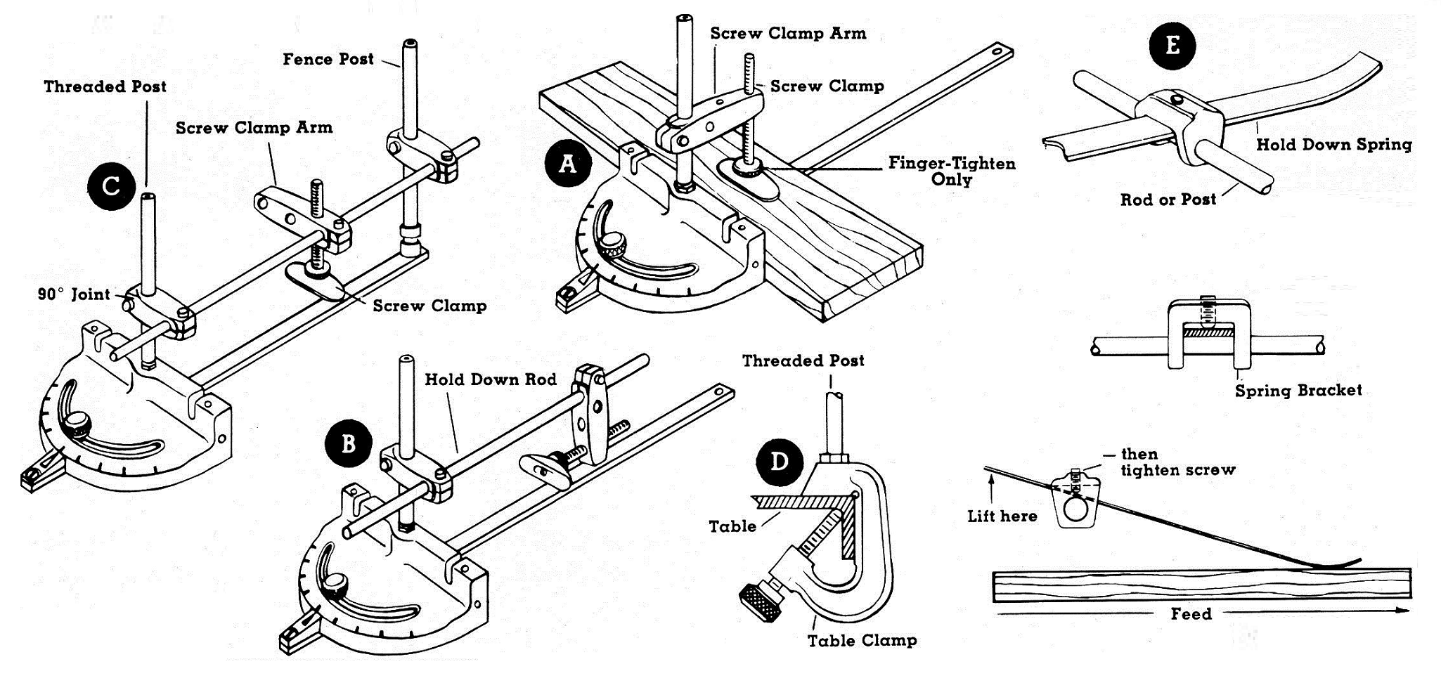

I don't know what you may have access to in your shop, but consider two miter gauges (one in each slot) locked in position in the tracks.
You can pass a longer piece of rod stock through the holes connecting them to form a much wider support, then clamping the stock you are drilling to both miter gauges. The older safety grips that had the knurled threaded rod were easier to crank down, but you should be able to use the new style equally well.
I would start with the headstock pulled back, advance the quill to drilling depth, then retract and move the headstock and lock it closer to advance the drill bit in segments til you reach depth.
Equally you can fabricate something with threaded rod, some nuts, and some wood that would work like the old style hold downs were used with 10ERs. With Two Miter Gauges, you can likely envision something that will work for you.
Everett
Using Hold Down in conjuction with Miter Gauge on 10ER.png (205.74 KiB) Viewed 7456 times
Hold Down Illustrations.png (883.25 KiB) Viewed 7453 times

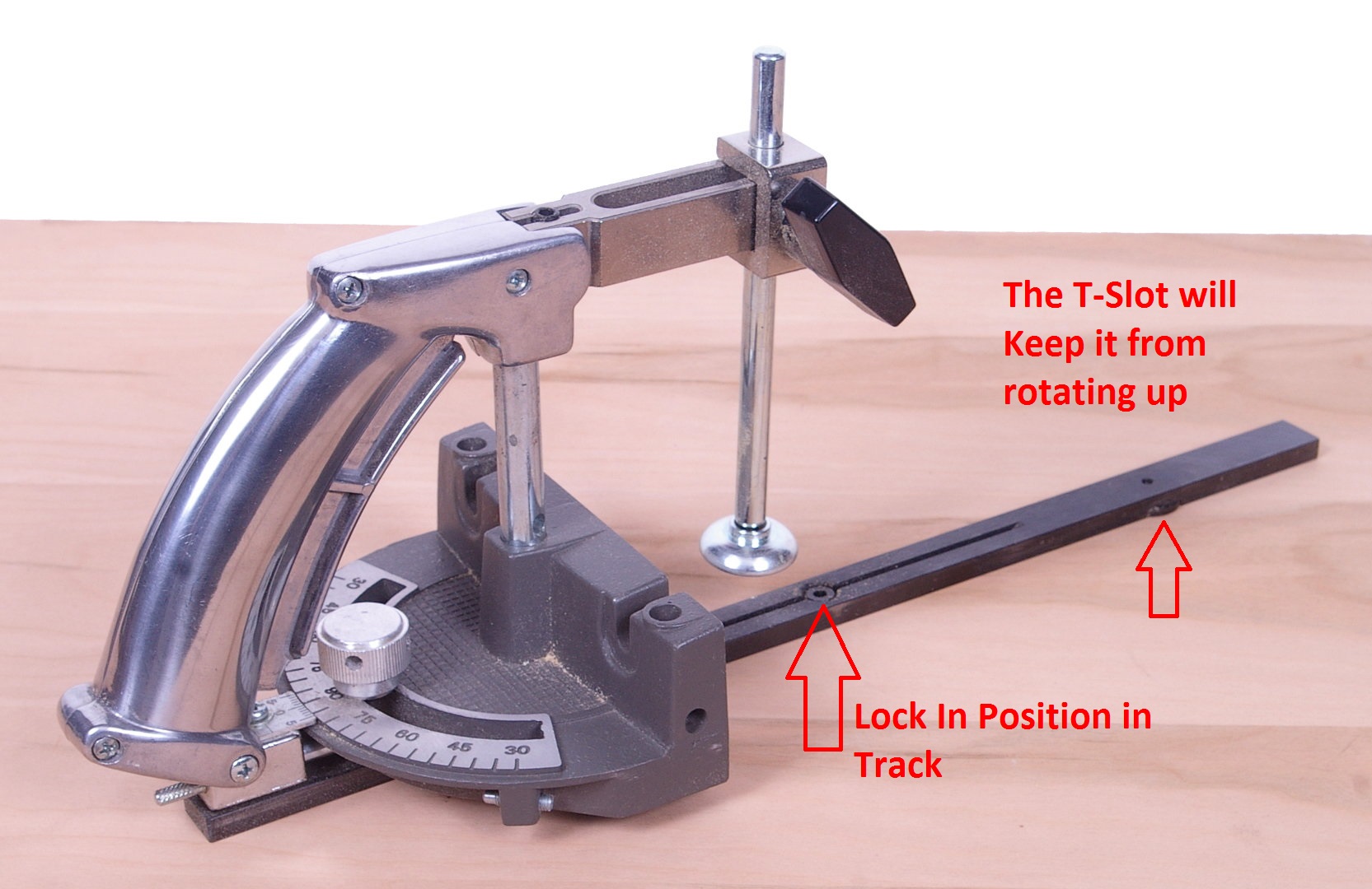

Newer Style Safety Grip.jpg (308.19 KiB) Viewed 7448 times
Here's the only way I know to help position it with just the Miter Gauge. I would place it in the slot closest to headstock to help it track true.
If you secure the lead edge of the bore, supplemental boring depth will be enhanced by the walls of the first segment, and sustained by the leading edge being secured by the grip.
Everett
