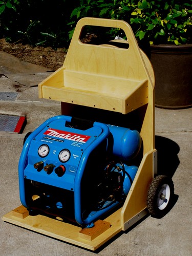

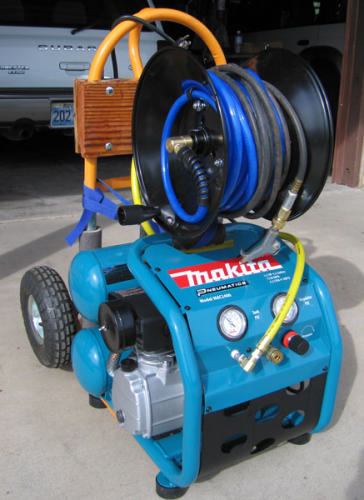

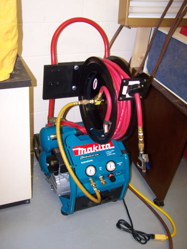

I was sold in part by the great reviews it got compared to other compressors, as well as, I have to admit, being lured by by that snazzy blue paint job. I also really liked the examples of homemade caddies some folks posted on Amazon:frank81 wrote:I like that air compressor. Good design, metal in all the places that need to be protected.
I especially liked the chopped down hand truck caddies with the hose reel added on...I'd have to buy a six pack for a welder friend to get it chopped and then repaint it but it seems like a pretty useful setup.

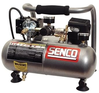

I have this compressor for my nail guns. Works GREAT!
http://www.amazon.com/Senco-PC1010-1-Ho ... ords=senco.
