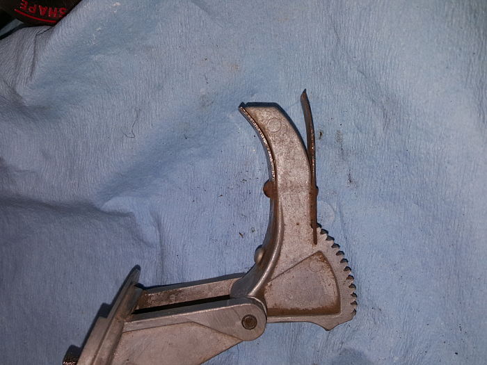

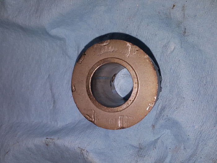

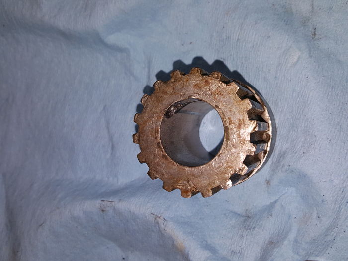

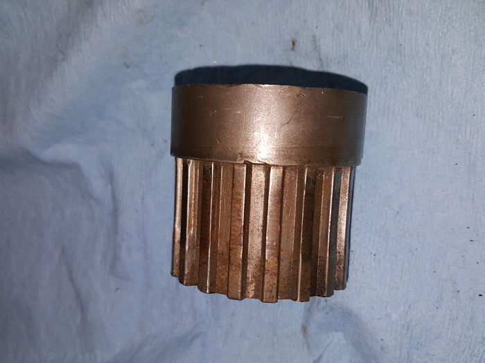

I pulled the bearing and Gilmer drive. . It does not have a clutch, it is one solid piece from what I can tell. I will also need a new pork chop and a wave washer for the quill lock as it is missing.

I would at least try to salvage the speed control. One(?) rivet and a strip of spring steel?thunderbirdbat wrote:I pulled the bearing and Gilmer drive. . It does not have a clutch, it is one solid piece from what I can tell. I will also need a new pork chop and a wave washer for the quill lock as it is missing. 20180718_161608_opt.jpg20180718_161617_opt.jpg20180718_161628_opt.jpg20180718_164716_opt.jpg

I ordered the pork chop and the wave washer the other day with some of the things from the sale ad. I am also going through the parts and adding the lubrication holes where they are now located.JPG wrote:I would at least try to salvage the speed control. One(?) rivet and a strip of spring steel?
