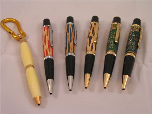

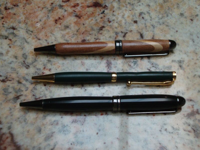

These were turned on the PSI Mandrel for shopsmith I think it works great.
The green and black are new materials to me called rigid urethanes. Where I work does rapid prototyping and urethane castings are part of the product offerings. The material came from the scrap that occurs when they pour the materials into larger molds it goes through 1/2" or 5/8" tubes and is just thrown away after the parts are removed from the molds. The Casting department manager is going to keep his eye out for these longer than 2 1/2" so I can do more. I gave him the black pen. I must say that these urethane materials really machine nicely. Finishing takes a bit more effort though as tool marks some effort to remove. Once the tooling marks are gone though, final sanding is pretty easy since every scratch shows, it's easy to see when to go to the next higher grit.
The top pen is segmented maple inside of mahogany drilled on a daigonal in designer style with Gunmetal hardware, sanded to0 800 grit with a CA finish which was then sanded to 2000 grit.
The middle pen is AFP 3600 a new material for our company tinted forest green. slimline style with gold hardware. sanded to 2000 grit for a nice satin finish.
The bottom pen is AFP 3100 tinted black designer style with gunmetal hardware. sanded to 2000 grit and then polished with McGuire's scratchX it left a very nice satin finish.

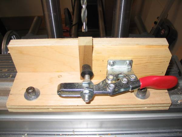

The last pic in your post is the correct mandrel for the SS. However you CAN remove the MT2 taper from the other mandrels and use the SS drill chuck. Just don'grab the mandrel shaft by the threads.:eek:
You can use the SS in drill press mode either vertical or horizontal to drill the blanks. A fixture similar to this one can be made from scrap material for drilling.
[ATTACH]12103[/ATTACH]
Stop back often and post some pics of your projects.
