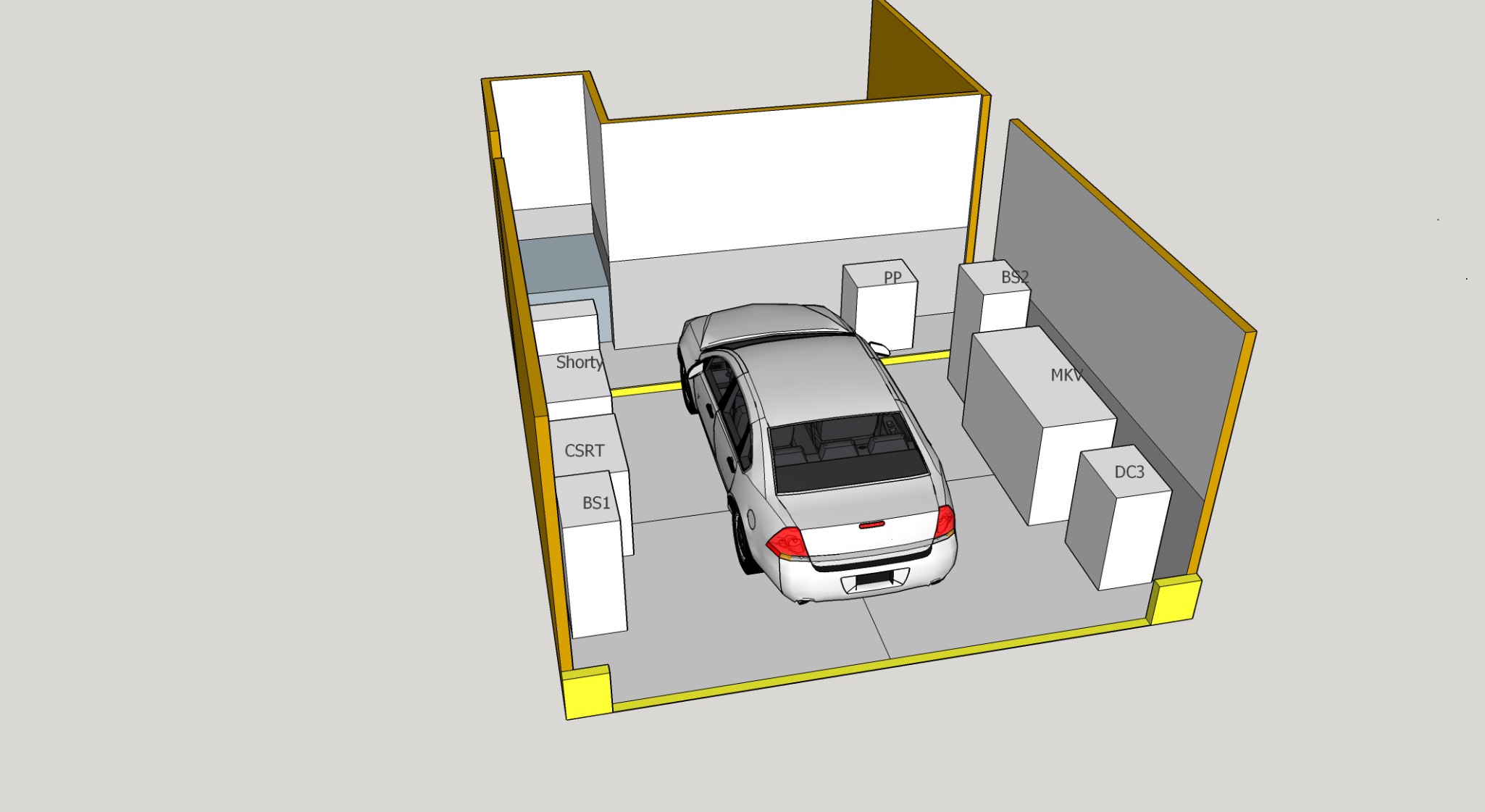

I have not given a lot of thought to physical arrangement but this is a block diagram of the available space with the Shopsmith items represented.
The car will not reside there but can be sheltered there. Missing are five metal wall cabinets (from Home Depot)and a rolling tool chest with bench tool (from Lowes).

Dusty, what are the room dimensions?

The garage floor measures 194" x 223"mountainbreeze wrote:Dusty, what are the room dimensions?
The raised area across the front of the garage measures 37" x 223"
The raised area is elevated about 4" and is something mandated by code. I think it was put there to give me something to either trip on or fall off of!

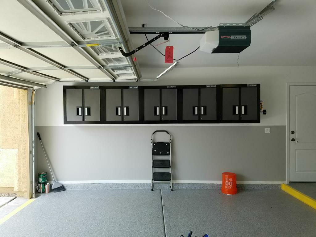

The Husky 15 Drawer Tool Chest that was expected yesterday did not arrive. There was some sort of issue with the documents required to get it out of stock and onto the delivery truck. That is suppose to have been resolved and I was told by the department manager that the chest would be delivered today. Sunday?? I'll not hold my breathe.
Other than that, the shop has been painted and the wall cabinets hung. Only time will tell if I now have them at an acceptable height. They are 55" above floor level. I think that will facilitate all but the belt sander (in vertical position) and the band saws (mounted on Power Stand). Those will have to be stored on the opposite side of the shop.
I can hardly wait for the day when I can call for the PODS to be delivered.
The cabinets look good and for some applications they probably are good BUT I would not buy another one. If they are going to hand on a wall with studs on 24" center and if the first stud is properly located they might be great. Unfortunately, I was working on a wall will studs on 16" centers (sorta) and only a couple studs were located where I needed them.
This necessitated that I hang a 3/4" plywood backer board to which a attached the cabinets. With the backer board in place, we began to hang the cabinets. It was then that we became aware of just how flexible the cabinet sides and back were. To gain some stability in the cabinets it became necessary to drill our own holes and to locate them (in the back) as close as possible to the sides. Without doing that, they cabinets were not rigid enough to maintain level and plumb.
I don't know that any of the other cabinets on the market are any more rigid than these but I do know that I will not buy and would not not recommend these to anyone.
They look good. We'll see how I really feel later when I start loading them with some weight.
To compound my problems, I found that the wall to which I attached the backer board was not straight. Due to the hump in the wall, the backer board has a 1/2" gap between it and the wall at one end. Maybe I should have hung these on the opposite wall!

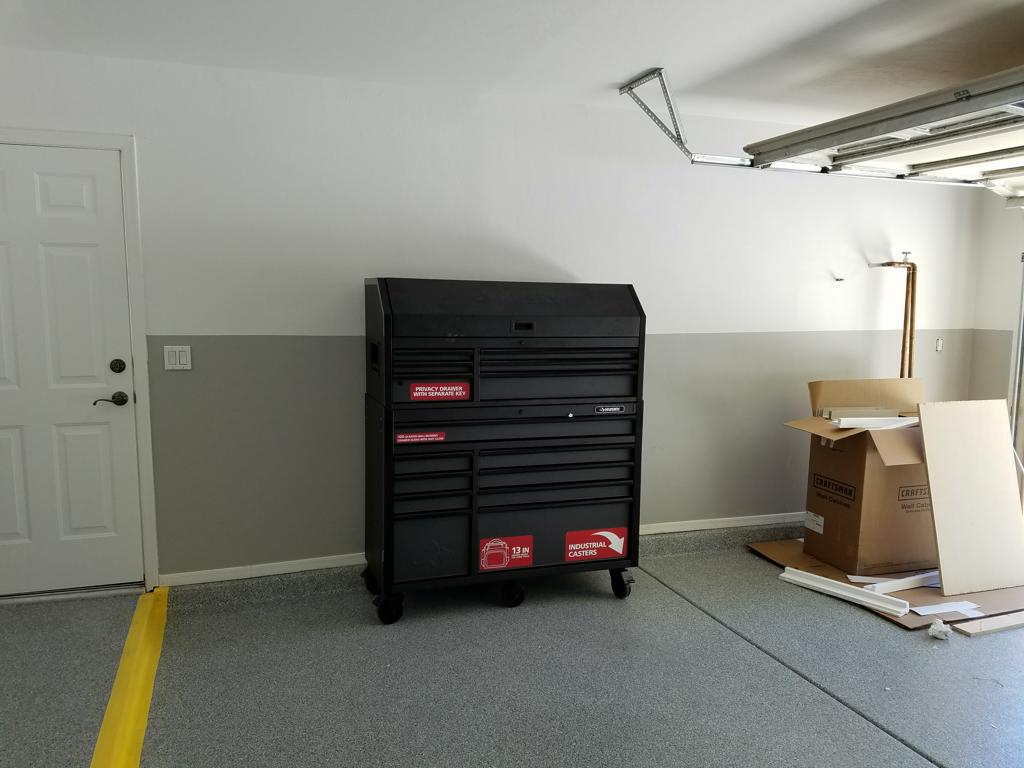

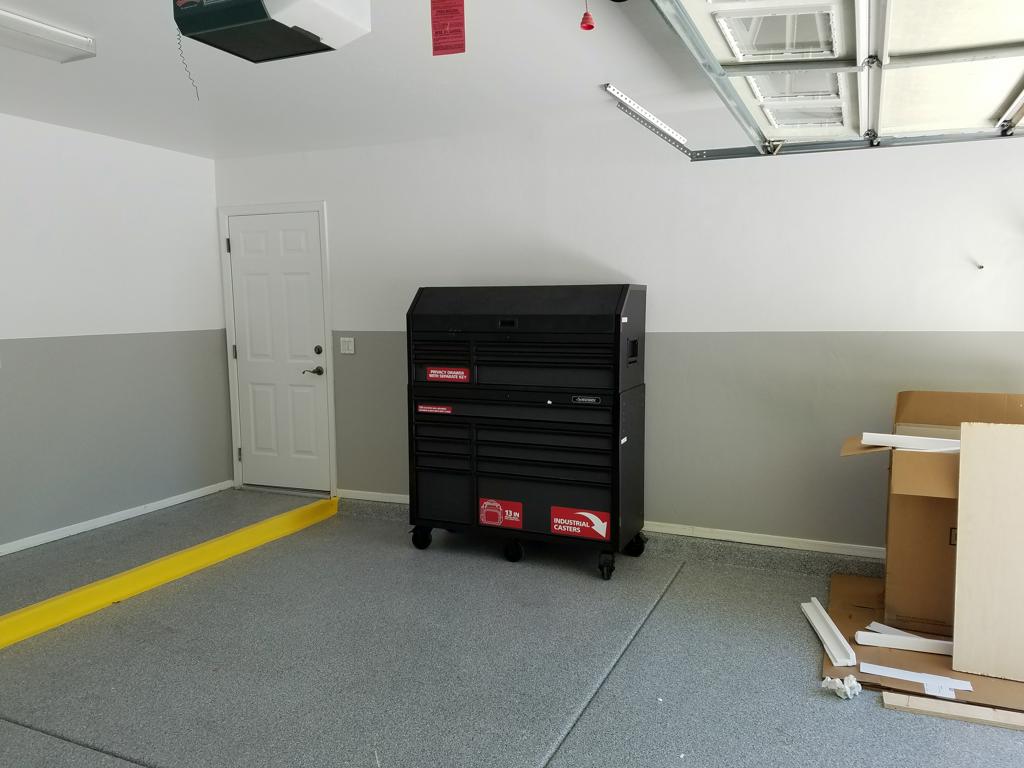

One more item has arrived. This is the last item unit the POD arrives.
The tool chest looks a lot bigger in the garage than it did at HomeDepot."Making Sawdust Safely"

You will have to get those pods delivered pretty soon or the shop will be full before your tools get in it...
Enjoy putting it all together. I would say "Don't over do it", but I suspect your wife has already covered that...
