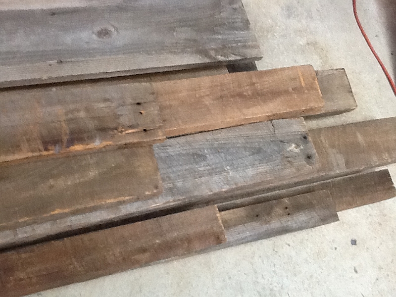

I told her if I built it I would use genuine reclaimed wood that shows the true character of age and not a faux finish. I told her I would have to find the wood as I didn't have any readily available. I managed to find the wood on Craig's list but had to pay double what new wood would cost and drive for over an hour to get it. As it turns out the wood came from old barns salvaged in north Georgia and was around 100 years old. The wood was full thickness and still showed marks from a circular saw mill.

Wood for the top and base. I planed the underside to a consistent thickness and skip planed the top to get rid of some splinters.

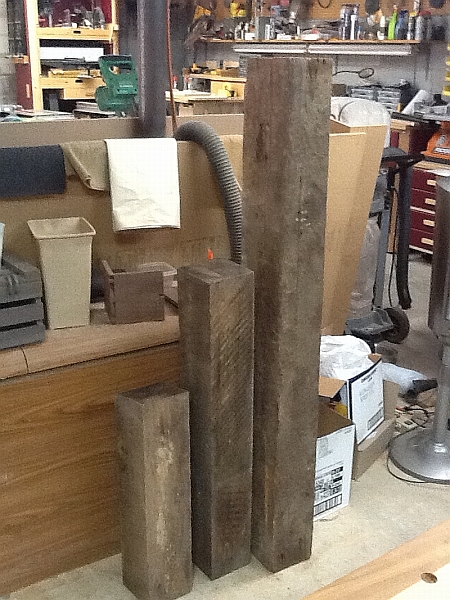

These are some ~6x6 posts I turned legs from. The turning was a difficult task as the wood was hard and brittle and prone to tear out and chipping. I was luck that for this particular table those were desirable traits.

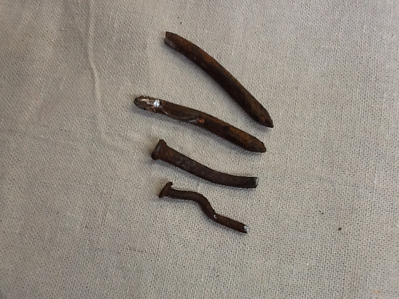

This is just some of what I found in the wood. I had to buy a metal detector to find all of the nails imbedded in the wood. Many couldn't be seen on the surface as the visable portion had rusted completely away.

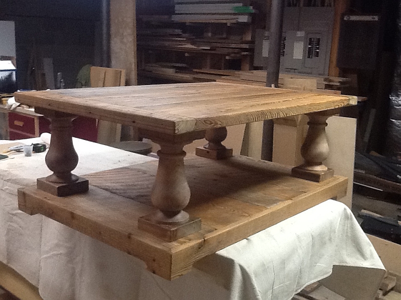

In the end this is what I wound up building.
Finished Table.jpg (366.68 KiB) Viewed 4625 times

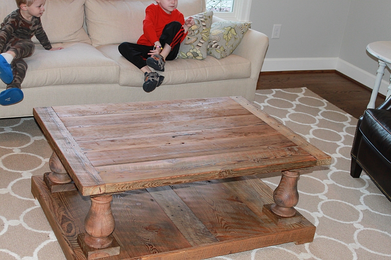

This is the table sitting in its new home with my two grandsons checking it out.
Turned out to be a fun project and challenging as I had to refresh what little turning skill I might once have had. I also had to figure out how to remove nails that you couldn't grab hold of and were sometimes imbedded by 1/2 to 1 inch.

That's a great job on the Coffee table.Gotta love the old reclaimed barn wood.I'll take a dozen of those table and will sell them in about two weeks I bet.Very cool design.you have a good eye to come up with that piece.

Very very nice! Nice design.
How did you do the breadboards at the ends?

Nothing very fancy. I left a 3/4" thick tenon on the top and routed a corresponding groove in the breadboard ends. I attached the ends by drilling holes from the bottom but not all of the way through the top to insert 1/4" dowels. I removed the end boards, enlarged the dowel holes drilled through the tenon to allow for expansion except for the center hole. I then glued the center 3" or so; put the end back on and inserted the dowels from the bottom being careful to only glue them to the breadboard end and not the top.

What a beautiful job ! Did you use a duplicator for the legs ? Old barn wood worth more than new wood. Makes you appreciate old barns a lot more. I grew up on a cattle ranch in Montana which was founded by my great great grandfather in the 1870's after the civil war. When I was about 10 or 11 my grandfather and father decided to get rid of the "great barn" as we called it which was really old at the time. They wanted to build a new modern barn. So on Christmas eve they invited all the neighboring ranches and they burned it to the ground. One of my best childhood memories ! Wish I had the wood now :)

Unfortunately, I don't own the lathe duplicator so I had to turn all of the legs by hand. I did it the old fashioned way by taking measurements and using a caliper to set my key depths. I also made a profile template that I could use to check my progress. They turned out fairly close but they are not duplicates by any means.
I actually had to turn nine legs as I made two tables(made one to sell and recoup the cost of the wood). The ninth leg was because the first one I attempted blew out a huge chunk that I couldn't glue back in place.

LOVE that table. How does it compare to the one the D-I-L saw? Bet the grand-boys are thinking "we CAN'T destroy that table." :D

beeg wrote:LOVE that table. How does it compare to the one the D-I-L saw? Bet the grand-boys are thinking "we CAN'T destroy that table." :D
The picture she showed me was similar in design but built from new wood and made to look old. To me it was very obvious it wasn't reclaimed wood and the distressing and finish just looked fake. She likes this one much better and got to see the building of it several times along the way. She also had a hand in designing the legs.
